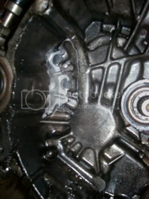

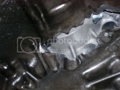

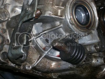

got some pictures of what happened... i know thier not the greatest but they were closing and i had like 3 mins to take some pics....
the trans we bought was junk!!!
i convinced the yard to pay the labor... so now i just have to find a new trans....
i have 406 dollars that i got back from the yard, so im looking for another trans for around 500... get that here and the labor is already paid for.... so it should get done right away....
