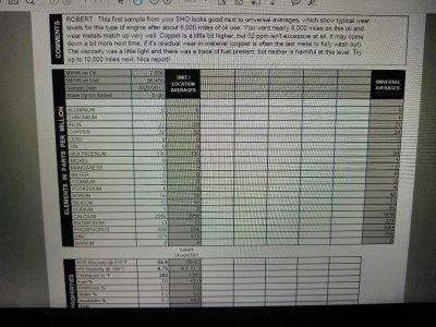

Just got my Blackstone lab report back. Using amsoil.
Any thoughts or suggestions from those in the know? 60b97e611c628950cd92488780ec0410
Sent from my SM-G955U using Tapatalk

Is there really any copper bearing material in these engines? I know the modulars used aluminum/silicon or something.

I would never go 10k on a change interval as they are recommending.
Ha. That's laughable.
I know 7500 is my normal. Got it changed as soon as I got back from a trip. 10k would be like going the full 25k as on bottle. Or using the new Mobil, 1 time per year, not in my lifetime, lol
9,045
4,390
Would not go 10k with those results on viscosity, flashpoint etc. The metals are likely due to the engine still breaking in, but what filter are u using? Wonder if it was already full up.
Using the amsoil filter

5w30 Signature? And your drive is mostly highway? I can tell you that dropping to 0W may not be a good idea esp if going for an extended OCI, OR if the drives are multiple hour drives, no matter what Amsoil says. Most people here using Amsoil are pretty fanatical about OCIs, I doubt they have really tested the limits of the oil/filter and had the oil Blackstone-resulted.
They ARE releasing updated formulations for the OE, XL, and Sig lines in September, hopefully it will have better stats.

I don't like that the viscosity is low for both temperatures. I would not run that stuff more than the 8k you did, and frankly I would pick something else as my oil of choice. The copper is a little higher than average, but nothing I would worry about. Just my .02
I have heard he copper is from the turbos but really don't know. I recently did Blackstone for the first time and copper was within range but higher than other metals. Blackstone report said it was common in the 3.5eb
Maybe a change after next change as I have 1 more change sitting in trunk and see what that report says. Copper is in there somewhere if they are saying it's normal. Maybe 2 changes from now will try Mobil or RPurple

Amsoil has 3 grades of oil: OE, XL, and Signature. To me, the only Amsoil oil worth having is Signature. The rest is flim-flam, if you will. Signature claims up to 25,000 miles/1 year between changes when coupled with their filter, for normal drive cycles. The recommendation drops to 15,000 miles for special operating conditions. No oil is immune. When the additives get used up, they get used up.
If you are using the MC filter, and changing ONLY the filter, follow the intervals for changing out the filter per your driving conditions, and top off the oil accordingly. This MIGHT work to get you the full interval as spec'd, but there is no data to fall back on regarding wear with this regimen. It is simply simpler :) to change the oil along with the filter. Ecoboost motors wear significantly more than their naturally aspirated cousins anyway, from the reports I have seen.

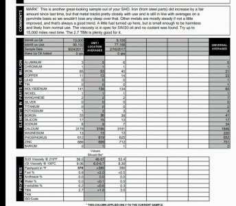

Thought I'd share my latest test result.
13,000 on this oil and the tbn was still pretty good.
Amsoil filter...
Db85d991e3f2889abdf923f8f11eec81

Looks pretty decent. Would not extend interval tho, as flashpoint is below spec. Dunno about the fuel in oil, don't think it is winter fuel contributing, could be increased blowby or an injector beginning to let go. Pure speculation :)
Ecoboosts are much harder on iron from what I have seen. Under similar conditions and mileage, you will rarely see the nat asp 3.5 iron in the double digits.
TAN is supposed to be more important than TBN, but I rarely see TAN sampled, so no experience with it.
