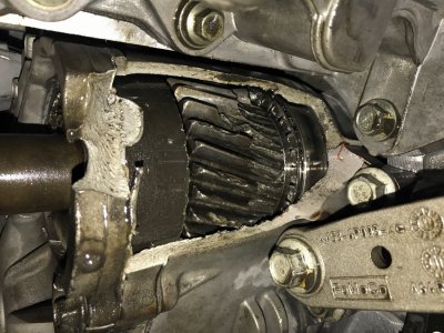

I've herd of this happening before here's a pic I found awhile back before I replaced mine.
This is not my PTU just worst case of what could happen.

Not much room for fluid in there. It's a shame they didn't design that the right way.

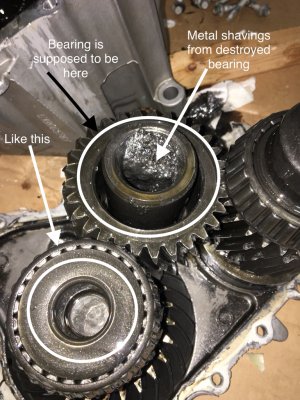

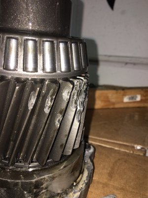

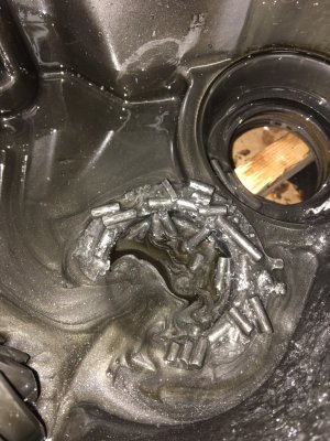

I'm really doubting pressure inside the case caused it to split open. That would take a HUGE amount of pressure to split a (cast?) case like that from pressure buildup alone. I'm guessing that bearing failed due to lack of oil, that caused the shaft to become misaligned, and then the shaft pushed against the case causing a fracture point.
I'm not saying that's the case, only my guess. I cannot see a case building up enough pressure inside to cause a split. That would have to be multiple hundreds of pounds of pressure and I don't see how it could generate that even with a completely clogged vent.
