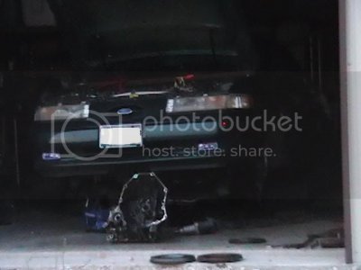

here is a pic of it in the middle stage....
80904863
With this procedure, i have got a trans swap down to 5hrs out/in... :naughty: and if your carful enough with the subframe, you wont need an alighnment.... if you drop the subframe off the car however, you will... but either way its still a good idea to get it done after wards. But FWIW, i never had a problem with the align. after wards with the procedure i use.
