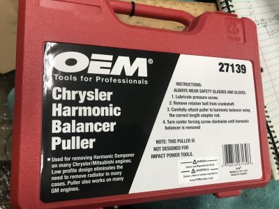

351Blueblood
Jan 5, 2018
42
23
Rent this puller from Autozone. Works great.
