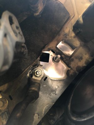

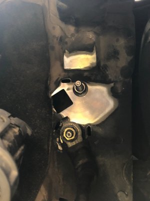

I was doing my big 3 wiring upgrade earlier today (finally) and I noticed the battery negative to chassis ground cable was kind of not in place. I tried to loosen the nut but it keeps turning with the lug terminal itself. The small tab that's supposed to hold the fixture in place for fastening is either broken or fiddled with. I just want to remove the cable and clean the area beneath it and reattach it. Looks like a solid spot for other grounds as well.
Does your battery ground to chassis look like this? Any idea how I can get it loose without damaging the lug terminal or cable? There is no way I can access the other side of this sheet metal.
