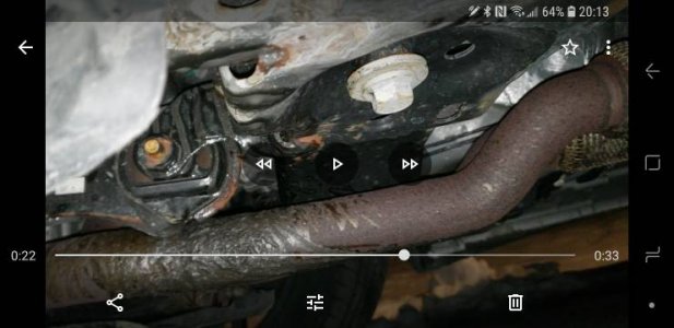

It's fairly thick, going to go out and take some underneath photos. Smells great outside, neighborhood should be happy it's 20 out and not 90 should keep smell localized until i degrease driveway.

I think you have a failure of a lubricated device with visual indicators. If the liquid is coming from the front I would concur it is likely the PTU. I have seen them grenade (crack in half) and not make noise to where something seems wrong.
If your under warranty, call the Customer Relationship Center and have it towed. Better be safe then to do more damage and get stranded half way there.

Yeah i am going to have it towed in the morning to Ford dealer. Man i wish they took the symptoms a bit more serious. The front end is coated. C7787d30eee8edb8f1e677b729d32a43

That's a quick look. I have the premium care to 125k miles, but thinking this would be covered outside of that. Man I was in there three times over last month for the smell. Once replaced axle seal, then put 4 new tires on, checked for smell and said all is good, last time in a week ago saying the smell is bad as it heats up and it shudders in reverse, again nothing found.
