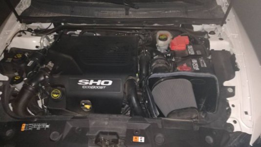

And the never ending story behind...love the sound it makes,. Now to wait for the tune.E7ba6a659c2cb74e36e4feb3c7d6ef42
Sent from my Moto Z (2) using Tapatalk
