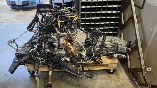

The size of this thing is very misconceiving.
1000029980
Took the radiator, intake and charge pipes off as those won't be used in the car.
1000029981
Wanted to see what front diff ratio it had and it's magically exactly what I need! 3.31 to match the mustang 8.8 irs with 3.31 that will be used in the rear.
1000029976
Also wanted to see some dimensions. It'll fit between the unibody the taurus has with about 6" to spare which is great. Better to have it too wide over too tight.
Really a super ugly engine lol. It's becoming very proven though.
