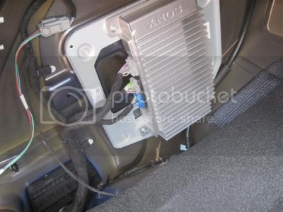

It's about upgrading the factory system with amps and subs. We noticed something in this thread that hadn't been discovered. Someone has a 2011 with the full Sony audio system and can't seem to find the dedicated subwoofer amp. It was there on the 2010... but not on the 2011. So today I went out to look at mine. Same thing. No sub amp.
IMG 1855
I started to do some testing and here is what I found. The two "subs" hardly that but more like a set of 6x9's that sat in the back window of every Trans Am and Cutlass in the early 80's.... are now connected to the primary amp.

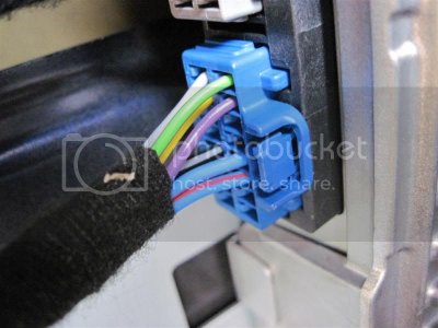

IMG 1856
The four wires at the top of this blue connector are the wires that go out to the subs. The blue/red wires are incoming power that power the amp. SO we no longer have the dedicated subwoofer. It did dawn on me that the bottom end of my 2011 system is no where near as good as the 2010 car. Fortunately though, this car drives properly.

Thats what I thought at first but the four wires that come out of the amp there have a slightly different color scheme than the wires going into the 6x9's...
And acording to this diagram that was posted,
AUDIO12
Those four wires are the signal for the sub amp?

It's the same wires. I disconnected both ends (from speaker and from amp) and tested the wire with an ohm meter. The color matches on mine perfectly to what is pictured. Look at the blue connector above... Grren/violet (although you can't see the violet stripe in that picture) grey, yellow and violet. They are all there.

ny
