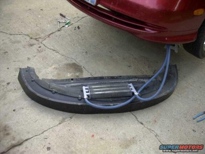

I plumbed a Hayden oil cooler to cool the coolant before it entered the oil cooler on my '97. I laid it over the gill slits on the lower plastic air deflector. What was nice about this set up is when stopped and with the fans on the air got pulled in from the bottom through the cooler, when driving the air naturally flowed from the top down through the cooler.
Oil cooler coolant cooler

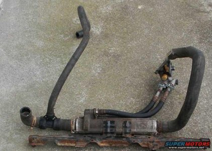

I may try this. I have a problem with the V8. There's a thread about it called "thoughts on oil cooler". But basically with the reverse flow of the coolant the oil cooler gets the hottest water in the cooling system. And while racing I usually have the heater going full blast. :nut:
I am considering a lower radiator hose oil cooler like the Crown Vic PIs use. I would have to use a oil filter adapter though.
Pi oil cooler
