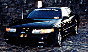

Ryan, that SHO looks great! Did you have it repainted when you had the car? Do you have anymore pictures?

Nope, that was the 7 year old pain (at that time) just after one of my many many washes/waxes. That pic was taken on River St. in Savannah Ga, at sunset....
God, I miss her.........
