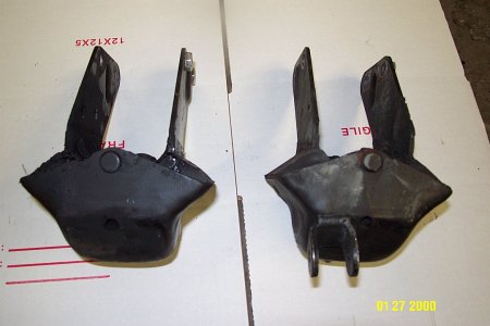

Here is my front motor mount btw;
Lots of vibration transmitted through it, but leaves me with lots of extra space and weighs about half of what the factory mount/dampener weigh.
