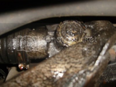

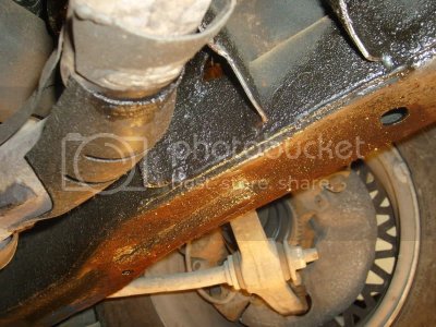

I was under my sho the other day looking for my power steering leak when I found this.
S7302226
S7302227

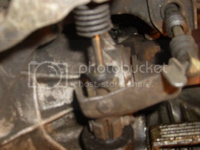

The end of the cable shifter. It looks like it needs a bushing or something on it. Where can one find one?
also found a torn cv boot
S7302235

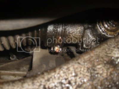

and the rack is soaked every where. I couldn't see where the leak was coming from so I quess its time for a new rack.
S7302234
S7302228
S7302233
Can I use a regular non vaps rack from a regular taurus, or do I have to buy the sho?
Or can I use a vaps rack and seal the extra port?
The rack will leak almost all the fluid just sitting in the garage. It started only when I went over 4k no its all the time.

My return line wasn't on the PS pump all the way and was leaking like that a few days ago. Only in the higher RPM's too.
As for the boot, I used one of the fix-a-boot from Autozone and it's held up very well so far. $20 and 2K miles so far! As long as there isn't too much dirt in the axle yet, it should work for a while.
Don't know about the cable though.

I don't think thats pw steering fliuid, more like oil. Check for oil on the passener side or back of head
SHO_ROLLER_2
Well-Known Member
Dec 27, 2007
765
256
Branford, Fl
It's red. That's trans fluid which would be in the PS pump. Unless he's got a transmission leak too.
Probably does have an oil leak though.
TwistedMunky
Nov 19, 2006
163
47
yakima,washington
I only had atf one day in the work van and used it. I just did front 60k. Its all atf, all over. I was only going to replace all the return hose. When I found this. How hard was the return line to get to. I thought It maybe came lose when I moved the reservoir out of the way for the 60k. Isn't it hight pressure from the pump to the rack and low pressure the rest of the way, so the pump shouldn't have a return line on it?

Notice that I did not say he could NOT use the regular Taurus rack, only that he was fine to use the SHO racks. No sense using a VAPS rack though. Best bet is to use a NON-VAPS SHO rack. I have a sneaking suspicion that the reg-taurus rack has a different ratio, but probably the same dimensions, so he can use it as well.

looks like you just need a new boot over the shifter cable end.
Most of that crud on there is the grease from the CV axle. Some of it is PS fluid.
You can use any SHO rack. I'm willing to bet you can use the taurus rack as well, but I'm not sure I'd recommend it.

..if im not mistakin you are missing a small bushing that goes into that cable end. junkyard or shosource has new ones I think.
