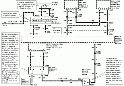

The AC clutch will come on if the lo pressure switch is closed, and if the hi pressure switch is closed. Then the EACT sends a signal to the AC clutch relay which feeds the AC clutch coil.
SHOZ123
Dec 2, 2000
12,152
673
Illinois
Here's the AC clutch coil WD for the 98 SHO. They call the lo pressure switch the cycling switch.
