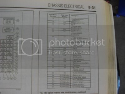

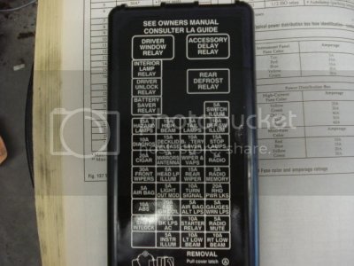

The fuse that I am pulling causes the blower to turn on and the football is dead when i start the car. Does anybody have a picture of the fuse box labels? I don't have a owners manual with the car...
