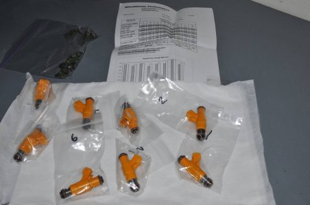

I have also been chasing a miss. I elected to buy 8 used injectors and have them flow tested and cleaned.
I think the injector you have is incorrect. My total cost for 8 injectors + cleaning + shipping was 200 +/-. That way I knew that all of them were good to go. ps I still have a miss.

ya, i ordered an injector sent for my car they seemed a good deal, and they were the wrong ones, they sent me the injectors for a dodge ram...weird
E1 v2
crash tested
Sep 22, 2007
305
56
holiday inn
Sandrew -
Looks more like a "Standard" Mustang type injector that you were sent.
Look at Wymjym's pic closely. See how short the distance is between the bottom of the plug and the bottom of the injector? Now look at your pic - much longer distance = won't fit. The fatter barrel will "fit" into your fuel rail or LIM, but the injector is too long to fit all 8 slots and come together properly.
Another fit issue I've seen in mail order SHO fuel injectors -
There are 3 common variations in "Our" injectors -
96 - 97 are a yellow-orange color with a square connector.
98 are orange color with a square plug.
99 are orange color with a "D" shaped plug.
96-98 types will fit all 96 - 98's in my experiences.
99's will only fit 99's.
