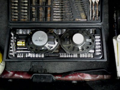

I replaced 2 times the entire system in mine (my JBL made with cones paper never want to work correctly, ending in reinstalling a MACH 80 from a SLO 97-99, but I kept the JBL sub).
The fronts speakers in doors (JBL and MACH) have a additionnal part on them to reduce high pitches at loud volume IIRC (some kind of resistance) and in the doors humidy attack this sensitive part. Even if all speakers are 6x9, the 2 front ones have a small cylindrical part on them near the magnet (black IIRC).
I resolved the problem by replacing the 2 fronts by 2 from the rear dash whose don't have this fragile part. The sound stay very good with this modification. As I said, you can find spares speaker in high trim Taurus from same years, just be sure to keep ones with the bigger magnet...
Or maybe your speaker could be checked and repaired by someone with knowledge in sound systems. (?)
