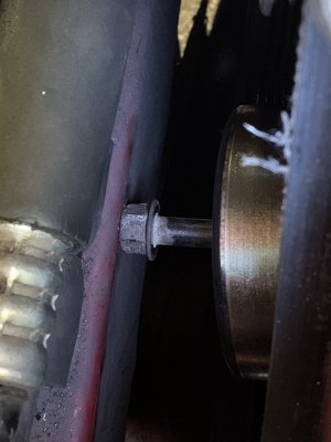

I've been having trouble loosening the bolt on the pulley but finally managed to free it today without rounding the head over. Then I ran into this situation (see pic). The bolt head hits the inner body/fender before it's all the way out of the threaded hole. Anyone run into this before? Any thoughts? It's close...can't be but one more thread to go before it's out.

The only way i saw to get around this was to zipped of the front motor mount bolt and jack up the engine with a piece of wood on the bottom of the oil pan.
13,266
that is the first I've ever seen this. never had this issue with the one I used to own. The post above seems the only logical choice as you are close to the clearing the top of the fender so mounts decouple and jack up to clear. Not sure how else to replace the pulley and same size/length bolt.

Maybe by simply prying with a solid and long bar on the engine (push it on the driver side) will give you enough space to retreive the bolt...(?) But watch out where you put the bar and try this only with a good helper (4 hands job).
