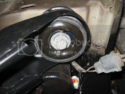

Is this installation correct on my '92, or should I have used the large washer from the recall kit? Using that washer would put the load on the raised perimeter of the bushing rather than in the center.

I used the washer.
When I approached 80 ft-lbs, the washer started collapsing. It finally collapsed the whole way and became quite concave before I was able to get to 100 ft lbs.
