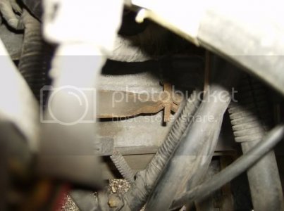

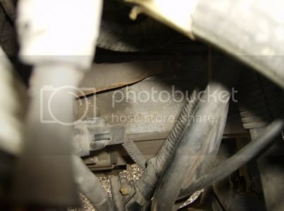

You cant even get this thing to idle in gear with the clutch pressed in without it creeping or lurtching?
Check to see if the cable is hooked to the right spot on the shifter arm. I posted some pics of the area...
Clutch fully depressed...
Clutchfork2
Clutch fulley released...
Clutchfork1

if i shut it off i can get it into gear start it it will lurch but will then stop. it does this off and on. ill be driving and the clutch will be fine, then the pedal will feel soft and i cant get it into gear, then sometimes a few tries later it will be fine for awhile i guess its an intermittant issue. its not slipping by any means
