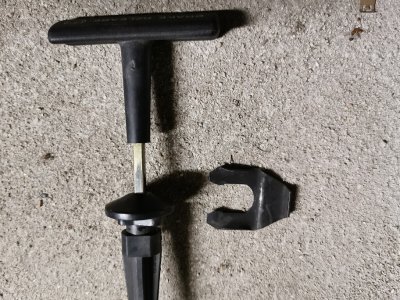

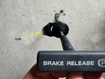

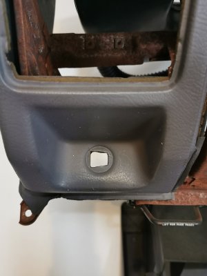

To get the release cable out, remove the autolamp panel by levering it out with a putty knife. Remove the connectors to remove it from the dash. If you look behind in the hole you will see that the cable is held onto the dash with a clip. Lever the clip up with a screwdriver and remove the cable.
Following this instructions from our colegue, put some pictures to ilustrat
