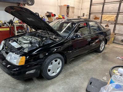

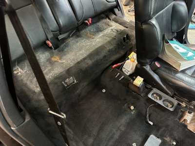

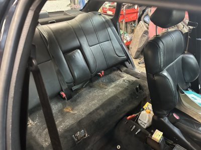

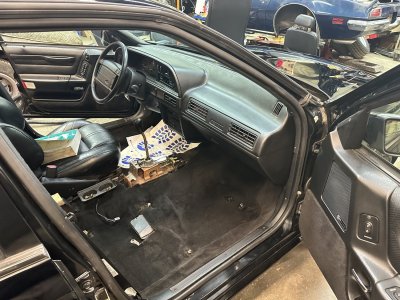

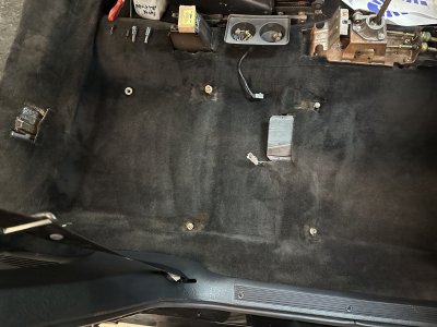

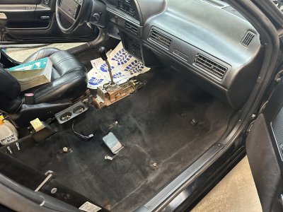

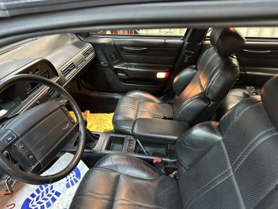

little revival of this thread. I bought the car. Mileage is correct as Tillman said there is accidents in its history. I am currently going through the car now

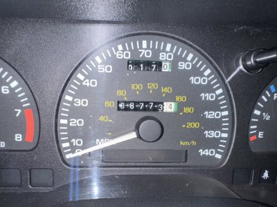

car had been wrecked into stationary object. Way back in the day. This car was at a towing company that I guess towed for the police quite a bit from what I gathered. But anyhow they ended up with the car the towing company an got ownership of the title years later an guess recently decided to sell it.. I drove 4 hrs in the car back to pa no hiccups on the way!!! All I did was put tires on it!! Drove like a brand new car. current mileage is in the picture
