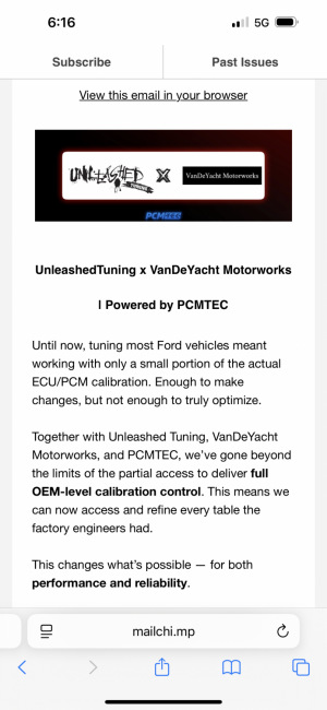

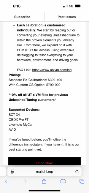

Oh no there is. MoTeC. We’re talking 15k ballpark.
Someone tagged me on FB to a major announcement from Unleashed Tuning. Reportedly Unleashed and another tech company completely unlocked the ECU to have all the same access as Ford’s tuners. Tune maps on the fly via cruise control buttons on the steering wheel. Launch control …basically standalone ECU access. Torie may be the next logical step unless again this old strategy is too old. Idk.

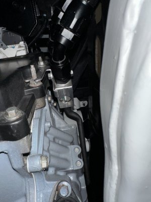

Brad and I are looking into the possibility of spending more time driving the car to get it shifting clean and crisp at part throttle. Possibility of trying a multi gear in manual mode. Also looking into the trans temperature settings as I believe there is a “warm up” strategy that perhaps we aren’t hitting bc the Derale high flow race cooler is working too well 20 min into a drive and perhaps the thermostat is stuck open so it’s below the threshold for optimal performance. I’m seeing temps under 100 but keep in mind my temp sensor is after the cooler. But maybe it’s only 140 or so. Maybe less.
Fresh off the trailer this car always went into limp mode. I actually found and sent Brad a Dragy video of a failed run. First run off the trailer and it refused to shift and bounced off the limiter. So this is NOT a new issue is what I’m thinking.
Changing the temp thresholds I believe is doable on the his end to tell the trans the new temps are “normal” and not “cold”.
Interesting development.....
Me thinks I can't help how that makes a certain other tuning vendor that used to make all sorts of claims of being the 1st (at everything) but now you don't hear much from them anymore.
Not mentioning names of course. LOL.

Right? Who’s their audience? Bolt on cars? Seems like something a race car needs. Brad said there’s so many useless parameters already in SCT he believes claims like that are usually not quite accurate. Maybe an element of snake oil.
We are trying something weird lol. In 2019 the car ripped really well for that tune. In 2020 the initial tuning was slower and on a hunch I flashed the end of season 2019 tune back on the car and it ripped again. So we are about to flash it back to that same tune more or less as a base add back whatever is vital from this new setup. But copying exact transmission settings from it. Should be interesting. I recheck trans fluid level and it was fine. The temp I’m seeing off the cooler is likely 40 degrees cooler than the internal temp. And the trans thermostat is brand new. It actually makes sense my temp is so cool (about 10-15 warmer than the ambient temp) is bc the cooler isn’t being used yet. The thermostat hasn’t reached 160 so it’s not flowing and I’m seeing the ambient + it’s close to the radiator that’s at full temp. Probably over thinking this trans cooler thing. It’s not flowing yet lol.

There are two different trans thermos....
I'd have to look back through (very old) posts and I'm trying to recall from fading memories....
But I can't recall if the difference was between the Non-PP equipped cars, versus the PP equipped cars being the difference, OR if it was the difference between the PP equipped cars and the Police Package variants, but one would open at a lower temp, the other at a higher temp.
I've been out of the proverbial loop for a few years now, but just tossing out some vague recollection.
Maybe someone else can chime in on the subject matter. There was/is for sure a difference, just can't recall which variants.
