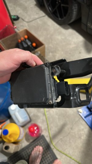

I may have found the smoking gun for the PCM and TCM. The ACC radar is deleted. Even not in use the ACC competes a vital circuit of information. That error fault could be the root cause of the TCM electrical issues as none of it seems mechanical. Simply plugging it back in even if it’s mounted facing the subframe it would satisfy that vital missing connection. Problems related to deleting things but keeping the stock ECU.

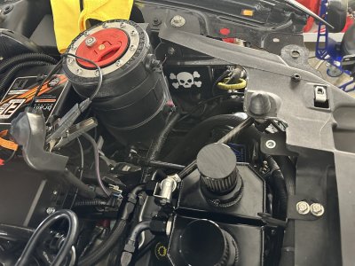

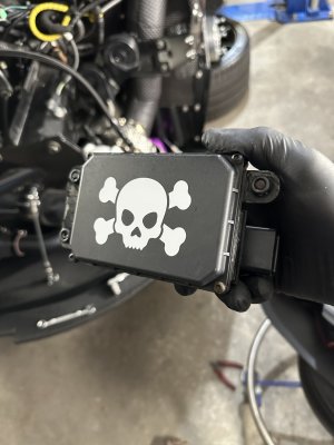

Dressed up the ACC. IMG 5844
So now the circle **** of signals will be complete again! It’s like having a cell phone. You’re aware of it in your pocket or whatever. If you can’t find it or misplace it your freak out. Same thing for the car lol it just needs to know it’s there IMG 5851

let me ask you this, first where did you whip up the skull and cross bones. second where did you find space to put it?
802SHO
Boost > VE, MBT, Cams
Oct 8, 2019
3,370
7,957
Essex Junction Vermont
Stickers I had from a couple years ago. Used to have 2 of those skulls one on each side of the front bumper. Had space available tucked into the outside of the fender. The missing link you can think of like a file. Computer crashes searching for said file. Reboot, upload file and computer is back to running smooth again. That’s how this should work. Better work I should say. All signs lead to this. @aaron240 unplugged his before he scrapped his SHO and said it made it drive wonky. I forgot about that. Mine was in pieces when he learned that. Another guy on FB I believe had same issue and plugged it in and let it sit inside around same area mine is now sitting. Will get acc is blocked message but can clear that.
