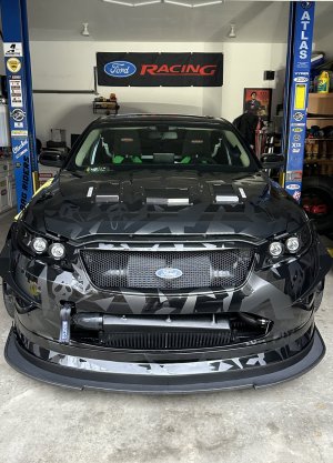

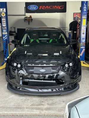

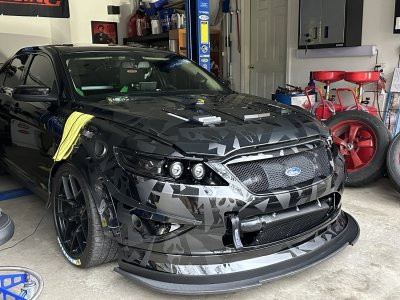

I’ve been enjoying time off from doing anything to the car. I moved it again out of the garage lol that’s about it. Man I wish it was Spring! But I’ll be on the roads as early as late March, beginning of April. I think once it’s broken-in tuning will go quickly. Make it to the track when it opens and it’s still relatively cool out. I impulsively bought a Ford emblem at O’Reillys lol. Should I bring it back? IMG 2858IMG 2857IMG 2856

I’ve been enjoying time off from doing anything to the car. I moved it again out of the garage lol that’s about it. Man I wish it was Spring! But I’ll be on the roads as early as late March, beginning of April. I think once it’s broken-in tuning will go quickly. Make it to the track when it opens and it’s still relatively cool out. I impulsively bought a Ford emblem at O’Reillys lol. Should I bring it back? View attachment 92788View attachment 92789View attachment 92790
Looks damn good, normally I debadge and black things out. With the rest blacked out the blue complements the blue Sparco tow strap.
