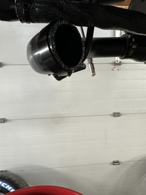

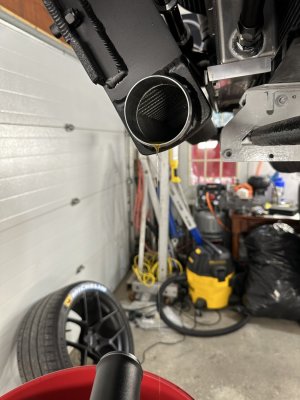

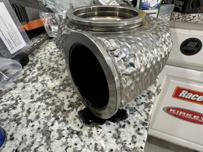

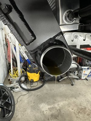

Oil out of the exhausts again. At least it was outside when I sprayed it out. I turned the car on and let it idle, gave it some light revs, changed its position and got out to check. Back to square 1….with more data. Better position to be in than with less data.
What’s happening? I am now unconvinced this pump can handle my 2 turbos.

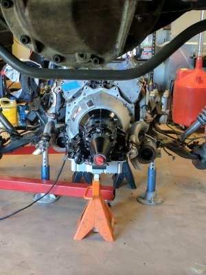

On my latest twin turbo Camaro build, I kept running into the same problem. LSX 376 with twin PTE 57's. I ran the same pump as you, turbos drains into a Y'd straight to the pump, back to the pan, and same thing oil coming out of the exhaust. Thought it was bad turbo seals. Had them rebuilt. Learned alot about turbo "seals" that day. Put them back in and yeah.....same thing. I put restrictors in, and that helped but it didn't cure the problem. I gave up on the project after my Powerglide ate the thrust bearing for second time in the motor (long story). Thinking back....I probably should have added another pump.........
Received 10155104454992521
That turbo/motor/trans combo was the ******* bane of my existence. Spend way to much time, energy, and money. But when I kinda got it right it made 803 hp, albeit briefly.

Man that’s one nice build! Yeah I’m basically testing things out and trying to find what works. I’m wondering now weighing my options, thinking about looking further into the pump. It’s rated for 1.75GPM. I could probably have success with a 3GPM rated pump and thats an easy swap.
It was. Callies Crank and Rods, Wiseco Pistons, Custom Comp Cam, AFR Heads........when it worked...it worked. When the trans killed it a second time, I was done.

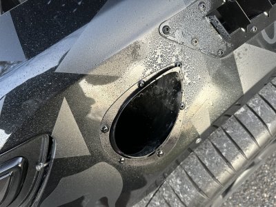

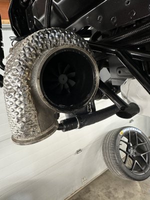

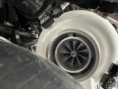

It’s almost like carnage but nothing is destroyed …so here’s the “mess”! Leaked on both sides of the cartridge, compressor and exhaust side. IMG 2665IMG 2666IMG 2667IMG 2670IMG 2669IMG 2672IMG 2671IMG 2673
Man how nice would Comp Oil less turbos be right about now!!! With those turbos you grease them every so often.
I need to remove these turbos and clean the shit out of them. So I’ll need to drain coolant again bc I added water…and oil again.

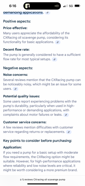

I’ve seen those. The first thing is the price, lowest price out there. For the cost of this MIL-SPEC pump …I could buy 4 of those CXRaxing pumps. I could just buy another pump…each turbo with its own pump. Completely redo all my lines again. Space is a big issue. I have space on the other side of the subframe where the pump is now but the trans is in the way. One pump per turbo and redoing all the lines would cost less than this MIL-SPEC pump but I could just swap in the higher flowing pump and keep it simple. 5 year warranty on the MIL-SPEC pump.
If I did do 2 pumps it would be easier to Y them up into the valve cover than into one of the OEM ports. I wanted to drop the oil pan but it’s also bolted to the timing cover and trans. Not sure I want to mess with that.
Idk man. It doesn’t seem plausible to me at this point that the cheapest pump available is going to solve my issues.
The only review about that CXRacing pump on their site is someone using it for a differential and cooling. The internet told me this IMG 2681
The only review about that CXRacing pump on their site is someone using it for a differential and cooling. The internet told me this View attachment 92385

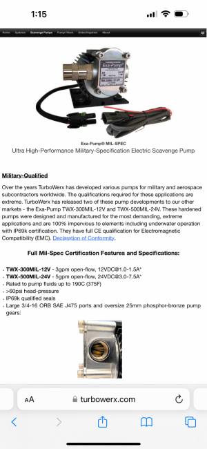

I think this guy Marc from Turbowerx is snarky and if I could find a better one I’d go with a different brand. IMG 2682
Throwing at me points that are honestly meaningless to me. G25-550 turbos weren’t made 20 years ago. Don’t come at me with 20 year old data. Garrett recommends 40 psi and I politely told him I deferred to the turbo manufacturer recommendation. Just rude responses. I pointed out the brand the recommended psi, the setups I started out with and what I changed and what happened. To be told 20+ years and 1,000’s of customers….then why didn’t you say any of that when I asked you about how I set it up in the first place before it was even tested? No mention of 25 psi…no mention about the fact that I said I bought the base model pump…where was the remark about everyone using the higher flow Exa-Pump?? So talking with Marc is why I devoted time into any brand but Turbowerx.
So he’s saying cut the psi and you’d be fine….so then I ask ok then so that Exa-Pump with 3/8 could swap places with the base model and be fine? And he’s like…well as long as nothing else is a miss in the system..yes. So he’s so sure one min then the next minute cautious to agree. So if I was to do something right now I’d pull the trigger on the MIL-SPEC pump bc all I’ve learned so far with communicating with him and how he’s so arrogant is he thinks the MIL-SPEC is a pump I shouldn’t need intuition tells me that’s exactly the pump I need based off his responses thus far.

The way he responds is a red flag to me but idk where else to go. The brand seems to have a good reputation despite his attitude. But if you imagine thousands of complaints…would you just mumble meaningless or made up facts…20+ years 10,000 installs never an issue…really? So the perfect pumps ever created? Not believable.
