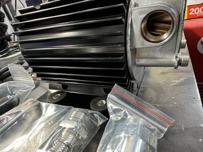

Welp, bought the MIL-SPEC Exa-Pump from Turbowerx. Did my research and all trails led me right back to them. I was sold on 3GPM open flow with 3/4-16 ORB inlet and outlet. I didn’t need it built to be impervious to elements but what the heck…consider the build a private military contractor vehicle. Also picked up another tank with more favorable dimensions to replace my Y fitting, dead center.
I’ve been looking into siphoning and what I think is happening when the car is turned off is all the oil in the feed lines gets sucked dry into the turbos. Pump is also no longer sucking. What I’m going to simply do is add more hose length to my oil feed, route it straight down to the subframe and have the Y there, then it will go straight over and have to go against gravity to each turbo feed. Against gravity is of no concern bc it’s pressurized but against gravity will stop siphoning from taking place without adding check valves. Or perhaps a check valve in an against gravity situation makes more sense to stop reverse flow…the way I have it now it wouldn’t be reverse flow it would just be checking pressure so it makes me weary it would work correctly. Hmm maybe I reroute and add check valves?
Solution seems to be throw another 1k at it and I hope this is the end of this fiasco. For F’s sake! Now just waiting to talk to a Garrett engineer when they open up in Cali. Got a number to call from a Garrett distributor. Just want to talk about the seals and make sure it really is just cleaning up the oil. They’re made of metal so idk what could ruin them but best to ask the appropriate person to make sure all my efforts are not in vein.

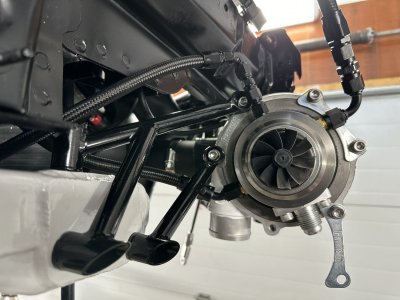

The other hole is adjacent to that one. I could rotate the holes idk how much it matters. That would be my question at this point. If the turbo was physically damaged then it would need a lot more than new seals…so for leaking bc of lack of a drain I’m not concerned anymore with …is just cleaning ok? I’d say yes. Nothing else to do.

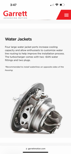

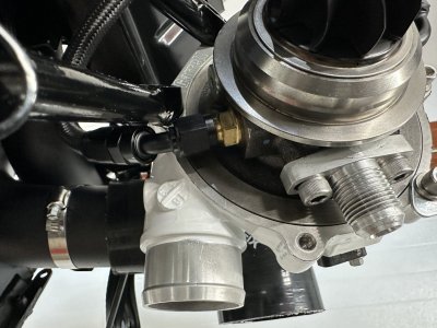

Here it mentions not recommended to have inlet and outlet on the same side for water IMG 2695
So my question was why? I’d assume it’s not ideal but my bracket is in the way on the other side. At least it’s in the way if I leave them clocked as-is. I hate when you find a recommendation with no explanation. I wanted to know if it was still ok if that’s all the space you have but since I’ve been unable to reach someone I went ahead and made the changes the best I could. If you’ll notice one compressor bracket bolt is about 90 and in the way if I were to rotate the cartridge more to the right to clear part of the bracket. IMG 2691IMG 2690
If I rotated it to the right the oil drain would also be pointing more up, so this way works and makes the drain have a little more of a better angle for draining.

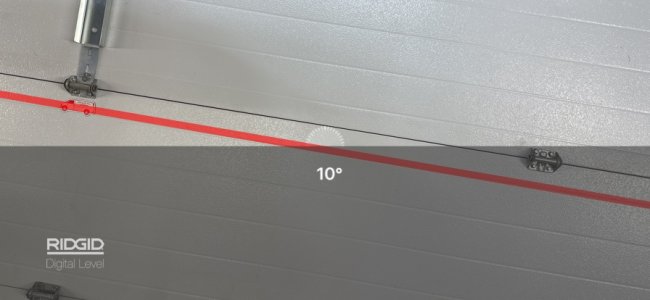

IMG 2694
The turbos are 9-10* and that’s within range. I found something from Precision Turbo stating:
We do not recommend a unit to sit more that 15* from center/level.

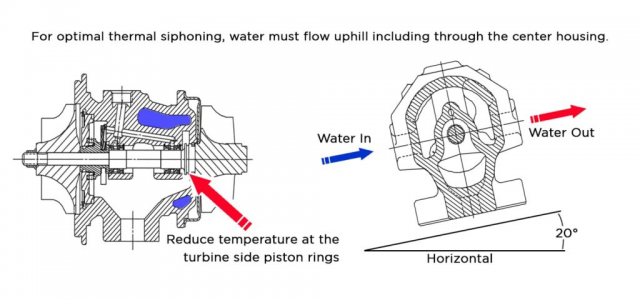

My educated guess would be, to have the water flow around to push water in, and pull heat out. If they are 90* it could possibly not wash cool water over the other 75% efficiently. SO in one side water flows around the entire housing, and out the other side.
Found this:
They speak to the angle of the oil port as well.

Assuming the water ports are unmarked, I think they want the water connections on opposite sides so that water flows over the bearing, carrying heat away. If the inlet and outlet are on the same side the water may bypass the bearing or not cool as efficiently.
It’s got inlets and outlets on both sides so it should all connect in the middle but I assumed not flow as good as it could but also before I didn’t have water at all for those first 30 miles..but no WOT stuff mostly granny driving so I’m sure everything is fine. I figured too hard to get fittings by the brackets and some water better than no water. But here I am with an opportunity to try again and figure out a way.

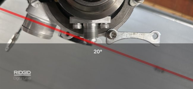

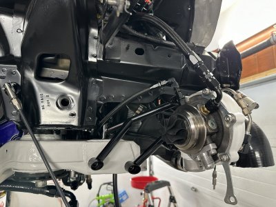

Ok so the axis of the turbo is 4*. The center housing it says for best results have it at 20*. What I was showing was the center housing at 10* not the axis.
This is the center housing at their recommended 20* for water. IMG 2699IMG 2701
I just need to swap my water feed and return. Having the feed uphill in the center housing is interesting I ran it the opposite way…regardless it’s all uphill bc they’re so low but it’s pressurized so it will get to wherever it needs to. But for the center housing I’ll swap the feed and return so irs orientated that way.
This angle will help the oil drain even more. I bet I had this at 4-5* before so another 15* will help for sure. Any slight angles seem to have an exaggerated impact
This is the center housing at their recommended 20* for water. View attachment 92417View attachment 92418

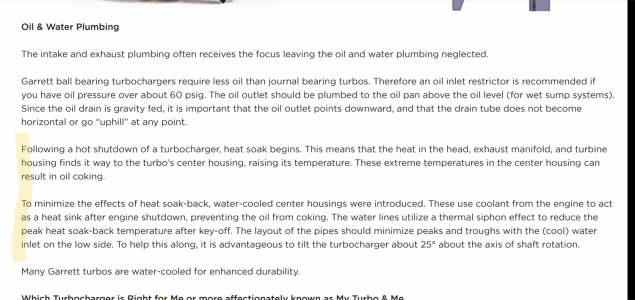

I keep reading about using oil restrictions with the incoming pressure since the water cooling does the heavy lift removing heat, however they don't use Journal bearings, thus need less oil. Could this help with scavnging....?
"Reduced Oil Flow – The ball bearing design reduces the required amount of oil required to provide adequate lubrication. This lower
oil volume reduces the chance for seal leakage. Also, the ball bearing is more tolerant of marginal l u b e conditions, and diminishes
the possibility of turbocharger failure on engine shut down."

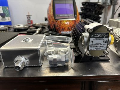

I received all the parts I’ll need yesterday. I’ve got maybe Tuesday and Wednesday to have this completed by and hopefully drive it to a cool place for pics and then snow is coming and it’s wrap for 2024.

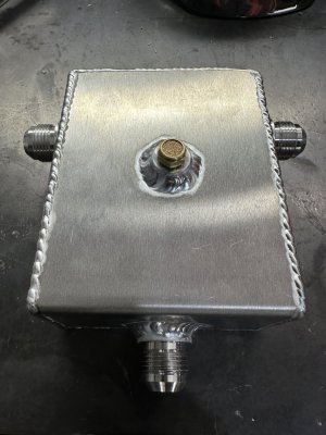

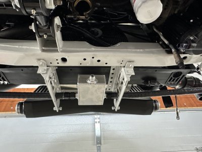

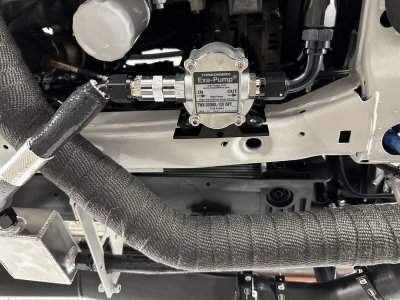

The military exa pump and new collection tank are very nice. IMG 2707IMG 2705

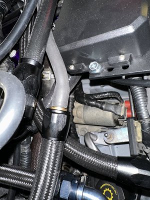

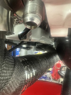

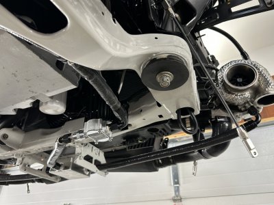

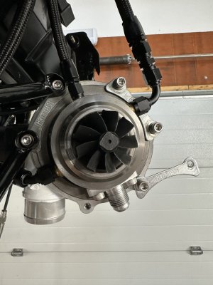

I swapped my coolant feed and return hoses at their T fittings and rerouted the feed lower. I also made a tall 90 for the feed with no new hose…just the existing hoses, then added a -4 female union, -4 male union to the 90 swivel. I couldn’t find a -4 female to -4 male fitting so I did the unions and made it tall. IMG 2709IMG 2708
I did hear back from Garrett directly. A woman left a voicemail she did say Garrett doesn’t directly support the end user so for further assistance to contact the distributor and ask them …but I already know some distributors can replace part numbers but lack actual technical expertise to answer engineering questions. Her voicemail said the engineering dept told her the turbo seals are circular metal piston rings and they should be fine unless they are overheated and coped with oil, causing them to collapse. Cleaning and starting over is fine. They also said water inlet and outlet on the same side is ok. For any further questions contact the distributor. Well, I’ve got them setup for thermal siphoning anyway.

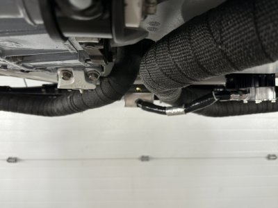

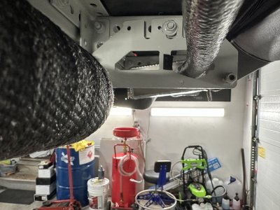

On my oil return off the the angle of decent initially is about 13* sloping down…unfortunately bc of my location the lines have to become horizontal and it slopes from 13* to level about 6-7” from the end of the hose but then it does go up 3*. And the hoses are tight…to thread them all I end up using a AN wrench. IMG 2715IMG 2716IMG 2713
This last bit of 3* bothers me so I’m going to remove some of the chassis mount metal to allow them to be level or even better my goal should be that they are 1* decline. IMG 2714
I’ll have to put the splitter on to see how much material I can remove. Of course if I didn’t have a chassis splitter I could lower them a little more but it is what it is. I should be able to remove material in the shape of the hose and get that incline of 3* to go away.

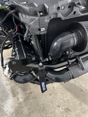

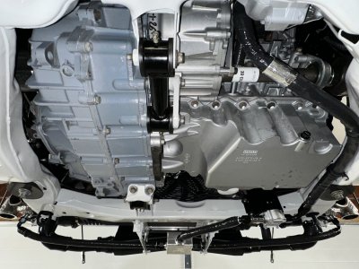

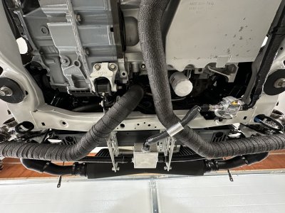

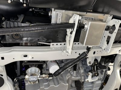

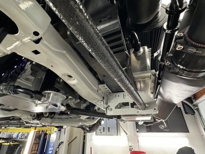

Thanks. It’s more like a constant battle of knowing how it should be orientated VS available space. These turbos are really low. Exhaust is all the way in the way too.
This is how it was looking …the line from the tank to the pump was level with the pump IMG 2727IMG 2731IMG 2730IMG 2738IMG 2740until the exhaust went back on. IMG 2749IMG 2751I let it droop down low right up against the exhaust otherwise it would have to go up over it and that probably would be the worse of the 2 scenarios. It made my tank slant downwards…that could be good? IMG 2754IMG 2756So what I’m going to be checking for is….when the car is shut down, there shouldn’t be anything in the return line attached to the turbo. If I remove it and it’s 100% full and to the center housing oil return fitting…back to the drawing board. The lines should be empty of actual fluid…some residue sure but no fluid at all. If the lines are empty of fluid it’s definitely working. It is a purtty pump IMG 2753

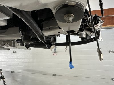

Chasing these issue really puts into perspective turbo placement ….i likely could have figured a place to mount them a little higher. Even 2-3” would help a ton. Ok so after redoing it all again check out how low these turbos are…look at the center tank below the IC….doesnt get any lower than that IMG 2769

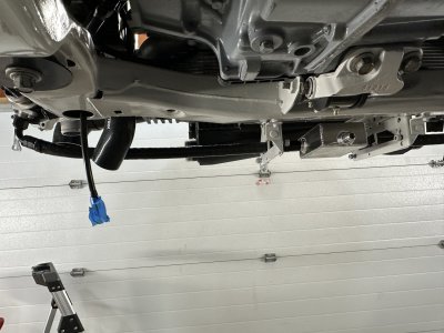

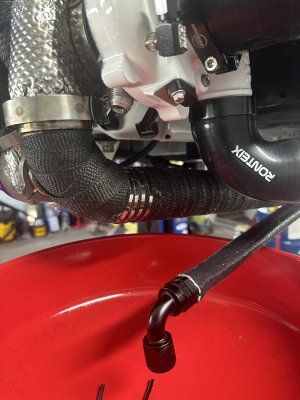

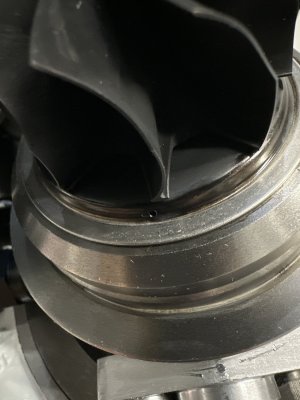

Test results: idled for 5-6 min, maybe longer. Gave it some quick revs. Checking for oil splatter and also to see if any oil weeps out of the tank breather element. Dry, dry. Took for about a 1 mile test drive. Mid throttle. Stopped and wanted to check some light smoke coming from turbo exhaust exits…looking for oil…dry. Drove it back, gave it one healthy rev…all the turbo spooling noises. Check exits…ok dry as bone. Wondering if regulator and restrictors too much now lol.
Up on the lift while it’s still hot. The -10 oil return fittings actually need the compressor bracket to be removed…if you can believe that. Remove the bracket, loosen the line and nothing!!!! Just a slow drip. Nothing in the line when turned upside down. When I let the line hang down lower than the tank some did trickle out but nothing much. Literally just trickled out. It’s working!IMG 4573IMG 4571
That’s what I wanted to see.
