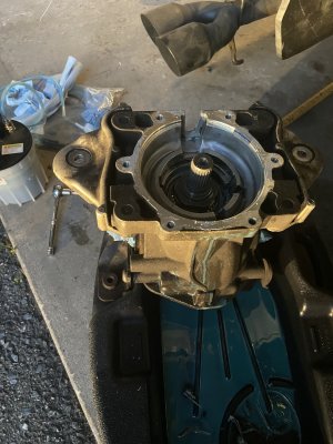

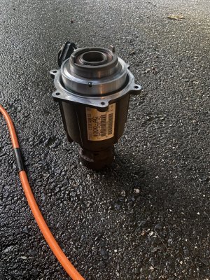

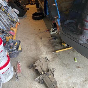

Small Update. Back in April I paid manufacturing costs to be a beta tester for AKD Built Performance to test their Billet viscous coupler and friction clutches for the RDU. All the parts are in and I removed my RDU, separated the top portion to be sent to AKD to reuse some internals into his Billet Viscous coupler and clutches. When that comes back I’ll reattach it to the RDU and back in the car.
It should provide up to 60% more grip to the RDU! Should substantially improve 60ft times. That and the rear end will need Jesus……going into uncharted Territory. :burnout:54BCC939 B949 4BFA BD0F D084173DFFA0E2BDDBA2 E367 4447 A227 4BF5E86BA858A08E68F0 8271 4D83 93D7 58DF0AEFDBB8

Great idea. Anyone know what the size of the ring gear in the rear differential is? Seven and a half inch differentials, can with protest, handle 3 to 400 horsepower. I know 7 diffs are safe to about 200 to 250 horsepower. 6 inch differentials are good to about 150 maybe pushing to 200 HP. The seven and a half inch differential in the Mark 3 Supra could be pushed into the 450-500 horsepower range. A bit small on the pinion gear size though. All this depends of course on how heavy built the components are.
Well there’s one way to find out. Let’s do it and see what happens!
AKD is also working on an LSD for the RDU.
I've got an older used trans I'm getting a hold of to rebuild with the new Raybestos clutches and going to send AKD the diff from the front...that would be a very big game changer
It should provide up to 60% more grip to the RDU! Should substantially improve 60ft times. That and the rear end will need Jesus……going into uncharted Territory. :burnout:View attachment 81532View attachment 81533View attachment 81534
Yeah!
