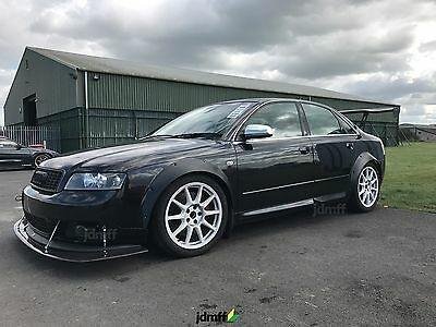

Maybe stop the flare somewhere around your last rivet in the front? Then just feather it into the existing fender.
Something like this?

I was just thinking an angle cut for sure. That’s why I didn’t drill the pilot hole for the Cleco pin….what I thought I wanted and what I saw didn’t quite look right….but then I was second guessing which way to go. Even though my front bumper and chin spoiler need to be fixed/repainted I wasn’t trying to drill a hole I wouldn’t use.
