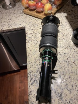

Finally received the AirTekk struts for my air suspension setup. I got the AirLift management, compressor and tank about a month ago.
And it doesn’t fit 10-12 steering knuckles…….so I’ll be calling AirTekk so that they at least inform 10-12 model years that they will have to upgrade to 13+ steering knuckles. I’m not about to bother with removing any hub/bearing assemblies so looks like I might as well buy those too! $450 added to the list…
So what’s the difference between the actual steering knuckle and bearing/hub assembly from non pp to pp? I’m thinking absolutely nothing…..in regards to hub/bearings bolting in and my SEP caliper brackets for my Wilwood Calipers. What do you guys say?
For a quick comparison, try looking at RockAuto. Moog has a lot of details on the info tab. For the hub, the hub pilot diameter seems to be the biggest difference (5mm). ****** shape is different also. Then there are a few other small (0.1mm) differences. They only list one knuckle so it can't really be compared between models (and it doesn't list specifics). I would say, as long as all of your parts match, it should be okay (either all PP or all non-PP).

I thought you had already upgraded to the 2013+ front suspension? The knuckles are completely different. The 10-12 has the slip fit struts that are held into the knuckle through compression and take 6 hours to change, where the 13+ is a bolt on strut that mounts to the knuckle and can be swapped in 20 minutes with air tools.
10-12:
MEF112 FRO  ra p 8197891  ra p
2013+:
MEF231 FRO  ra p 6038 ULTRAPOWER FCS 1333489L 1  ra p
Much better options for 2013+ suspension as well and it really doesn't take much to transfer the components over.
The 10-18 all use the same bearing/hub assembly, so you should be fine to transfer over there. Brake geometry is likely different though as the caliper brackets are also different.

So what I still had was my 2010 knuckle, I considered swapping to 13+ but decided not to. And bc I have the Wilwood Calipers I was able to run a 13+ rotor without issue on the 10 knuckle. As far as I know the only difference between 13+ and 10-12 knuckles are the strut attachment…..and 13+ have larger brake calipers but the actual bolt location for the calipers are identical to 10-12….which I was able to run the caliper brackets for Wilwood.
The brackets are the same. That's why 2010-12 cars can do the 13 + big brake upgrade. Meaning the brackets for the upgraded will pull trade on the earlier hubs and Knuckles.

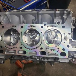

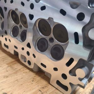

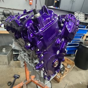

I think the heart of the ol’girl is about to finally come home! I’m supposed to get a full invoice Monday or Tuesday and once it’s paid, shipping will be arranged.
