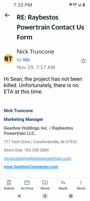

And just to confirm I received this email just a couple weeks ago, looks like the Raybestos disks will be a no go. Even though they stated the project isn't dead, but sure looks like it's going to go nowhere.Screenshot 20221207 193324

This is same answer I received from them. I am going on 3rd trans and really wanted better options.
