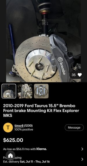

Just want to confirm that this is the same person on eBay that is selling the kit?
Because I’m in the process of acquiring the parts.

Tim Spencer sells them. I’d say that user name is Tim. I’d be comfortable buying them. Tim probably needs to get them sold and the normal SHO channels haven’t helped enough so he’s on EBay. That’s my take.
