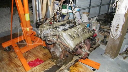

Anyways I didn't meet my goal of pulling the 3.0l but I did make progress...
Got the 3.2l stripped and ready for the mtx and accessories.
100 3230
Pulled most of the tubes/hoses/electrical connections off the engine, including the main engines harness. Removed both acc belts, pulled off fuel rails/injectors. Disconnected the rod shifter, drained coolant, drained oil, drained PS fluid.
100 3231
It's too dark to continue on but first thing tomorrow I am pulling the axles, finishing disconnection of anything holding the 3.0l to the car and pull the sucker out when my friend shows up.
My hope is that by tomorrow's end I'll have the 3.2l buttoned up and ready to go back in.
I also plan on replacing the sway bar, end links, steering rack, and tie rods with the fresh stuff I have off the 3.2l sub frame.
