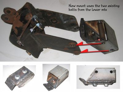

Technically all the 3.2 accessories are superior to the 3.0 ones ..... I ended up using the computer wiring and all the accessories from my 3.2. My car is an atx and the computer thinks its an atx but it has a 5 speed bolted to it.

^ wow you did it the hard way.
I wanted to keep all 3.2 accessories. IMHO the single belt system is much better than multiple belts.
So for me this was really the only way to do it. And it only took 30 hours to fabricate.

If I had a welder when I did my swap, I would have kept the 3.2 accessory setup. I'm kicking myself for dumping all the 3.2 stuff, now I can't even go back to it. 1 belt > 2 belts.

In the end of things its a matter of preference. I prefer a single belt and its a unique thing to see b.c. most 3.2 mtxs are done the "easy way".
Besides I love to fabricate things so this was an excuse to get my grinder and welder out and go to town.

GOOD JOB! :thumb: There is another guy in Buffalo NY (Mike93) that did the same thing.
22932960002 large
And I know its not the easiest route.
IMO the challange is part of the fun and the rewarding feeling of driving these cars. For me it is not just about opening the secondaries, I have just as much fun building parts for my car as I do driving it. I guess this is why I became a mechanical engineer :nut:.
