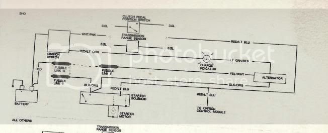

there is a red cover on the end of the solenoid (unless it has fallen off) pull this off and there will be two large studs with nuts, one conected to the battery cable and one conected to the starter motor istself, use a screwdriver and touch the two terminals at the same time, (expect some sparks) if it cranks than its a bad solonoid or somthing is not triggering the solenoid, if not its a bad starter motor, if it cranks then pull the smaller conecter on the solenoid located on the side of the two posts and apply power to it with the screwdriver across the battery cable terminal, if it cranks then there is nothing wrong with the starter/solenoid and your problem is most likely the key switch or something else down the line like the clutch petal interlock or somthing, good luck!

Starter is good. The Ground on the starter had come off. Free Fix FTW.
