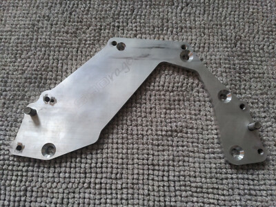

I did find an adapter on eBay that reads correctly:
It seems promising especially if it will get me towards a tremec transmission... I like that idea a lot for the short term!

I've read through several decent threads on here, but most of them lead me to broken links for parts from years past.
I also found a thread on a Mazda forum that had a LOT of great information for about this exact conversion.
if you facebook go to the group RWD sho (yamaha). The guy that makes those ebay adaptors is there along with a bunch of other rwd conversions. they have all the info.
AWESOME! That's great! I don't currently Facebook, but now may be the time again. Thank you!
