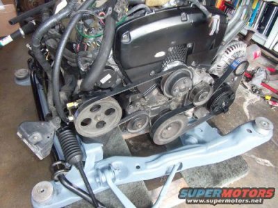

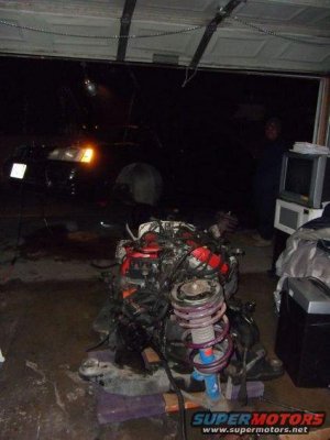

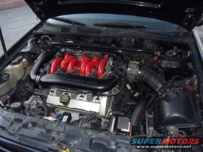

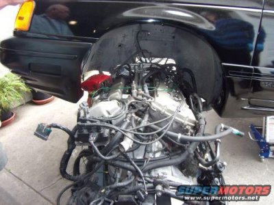

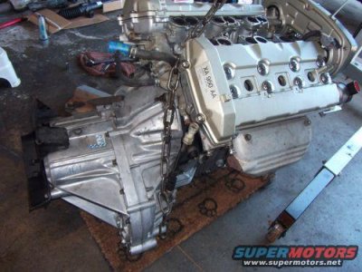

Installed new: Water pump, fidanza flywheel, clutchmaster stage 1, rear motor mount, mtx motor mount, top 60k, front 60k, rod bearings, valve stem seals, power steering lines, rack and pinion, starter, rear main seal, MTX output shaft seals, MTX fluid, A/C compressor, A/C o-rings, heater hoses, and thermostat.

Nice work! I'm sure it feels a long younger now.

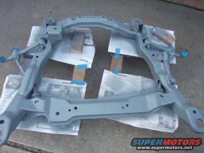

Didn't want to go to a Gen 3 subframe while it was out?

Thank you. The SHO runs way better now. I was considering Gen 3 bushings but I didnt have enough time to order and wait for them.
