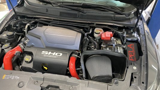

okay so i am new to this forum but would greatly appreciate any of your guys input,
i have a 2016 sho non PP
car currently has -
.28 gapped plugs
170 thermo
3 bar map
araid CAI
EPP hot pipes and noisemaker delete
Gearhead intercooler
stainless works high flow 2.5 in downpipes
stainless works catback
car is currently running livernois tune, it runs decent but am having issues with trans temps. have any of you added the PP aux trans cooler or used aftermarket?
and also what are or who are you guys using as far as tuning goes with these bolt ons?
thanks in advance

You have gearhead parts, just contact them for a tune. Its a stretch, but GH trann y smoothness may make some problems ease up at least. Best to add the pp cooler and change the trann y fluid. Just doing 1 drain and fill took my high temps away.
If you add pp cooler, get oem. Aftermarket ones are cheaply made. The mount holes are threaded into the crash bar already. At least they were on my 15. And install is easy. Cut the 2 hoses and T off to the new cooler. It will still run factory ac/tranny cooler and the aux cooler

Here is a list of the faster guys along with the mods and tuners. IMO I would skip ssi and lms. try a simple drain and fill a few times on the trans. Mine runs on a normal day will be around 160* 2013 PP
