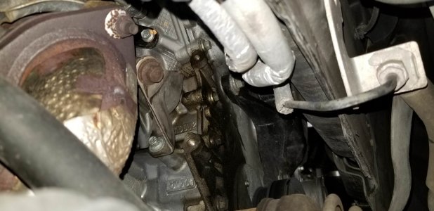

Turns out transmission fluid was low. I had to add just over 2 quarts but everything is running quite smooth now. I wonder how long that has been going on, I've only put about 30 miles on the car since I bought it so hopefully no damage has been done. I also replaced the air filter and will probably be doing other recommended services here. I did see some signs of leak on the right hand side of the engine and my serpentine belt has seen better days. Any idea what that leak might be?

Simple fixes are best LOL.
Sorry no idea as to the leak. Could be front cover, motor mount, control arm bushing, ptu-axle seal ... Thats what I would look for on the right side.
