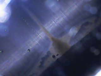

I have a picture from a scope camera but I can get a better picture when I get off work. I’ve talked about this with multiple mechanics and machine shops telling me the block is toast. Now I’m learning they are possibly completely wrong
I can't tell anything from the photo. Did you try putting a new injector in? When you say 'top' of cylinder four, do you mean 2-3mm below the head deck? Does 'tiny' mean measurable in microns? Are those scratches going up and down the bore longitudinally?
SHOBLOCK
Yes the photo is hard to see but no i haven’t put an injector in yet. I shut it down but had to crank up to get off the road but when I cranked it up it blew the head gasket from the unburnt fuel. I haven’t had much time, until now, to do anything with it. The “scratches” that i can see are up and down with the piston movement. They seem to be maybe 1/4 inch or so. I’m pulling the head now to get a better look
Where are you in Florida? Yes, pull the head to be certain of the damage. though not optimal, It would be easier to try to hook up the '11 replacement motor than to try to swap parts between a '17 and '11 motor. If you put the '11 in the car, it's uncertain how well the old motor will adapt. I would focus on fixing the '17 with '17 parts, based on what you find with the teardown. How much do you have in to the '11 motor?
