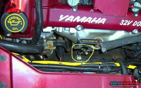

I pulled it out just now. Seems the nut came loose (no locktite) causing premature failure.
