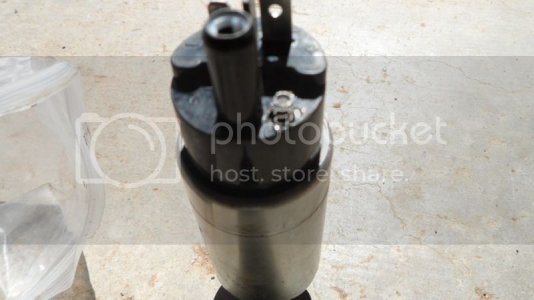

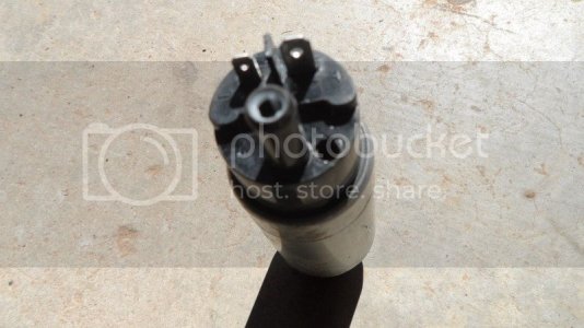

Back to the Possible fuel delivery problem. This is what I found.
Notice the hole, to the right of the taller or outlet tube.
SAM 1282
Now notice the Spring coming out of the hole.
SAM 1283
under that spring is a small metal ball. this I am assuming is a check valve I was surprised to see that the retainer was gone. the spring was being held in place by the fuel line. the new pump was almost identical except that there was a small 'washer' still holding the " check valve" in place, the way it should be. I am going to hope this cures my intermittent stalling, and rough starting. keep your fingers crossed.
Thanks again for everyones help.

Try this when it won't start: Turn the key from off to on (not start) position, and listen for the fuel pump. It should run for a few seconds and then shut itself off; the fuel system is now primed. Leave the key in on position. Depress the schrader valve. If you do not get the geyser Rubydist describes, the fuel pump is bad.
Ok it still does it, but it recovers faster Check the pics of the old fuel pump I posted there was a problem. I'm now going to check the return valve on the fuel rail. I will refer to the Ford Shop book for the procedure. unless someone knows a better way to check this mess out.
