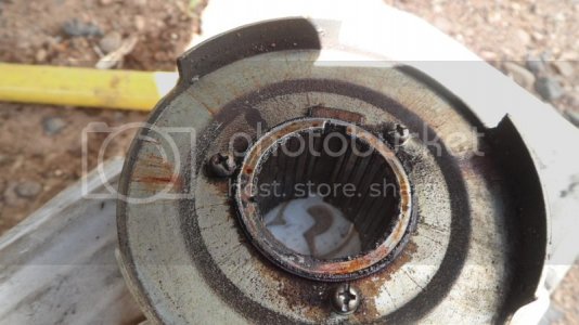

I did get it torn down who ever did the Last timing belt seems to have some Knowledge of these types of Systems the did use anti- seize on the harmonic Pulley. it came of with ease and it does seem to be off a tooth I have had time to take the timing gear off though. it started raining and the wind picked up alot. one the I did notice is alot of fluid thrown from the power steering pump I'll have to change that. and while I'm at it I will swap out the Cam sensor with a used one I have. It may have some fluid in side it and in the electrical connector, Since I'm already that far in to it.

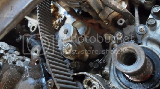

the lower gear looks Great popped right out ( but it was firmly seated) anti-seize must have been used there too i could see a little . There was a little oil, very little. in the area . so I went ahead and re installed every thing back as it was. I used a vise with aluminum jaw covers and slowly collapsed the belt tension er it was pretty firm no apparent leakage.
SAM 1189
SAM 1190
SAM 1191
From there since every thing was out of the way i installed a good used Cam sensor from a running engine. while I was removing the old sensor the pig tail retaining tabs snapped of so i get to change that plug. I will finish tomorrow.
