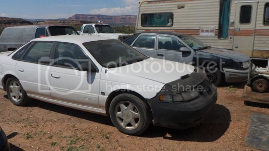

Had to show Pics white is my 95 , The black one is my wifes 98 baby. Yes it will be painted this summer.

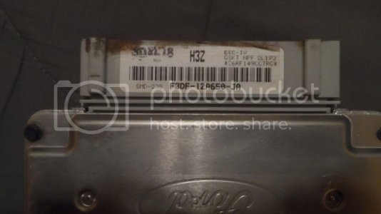

Here's the one out of my 93 I need to clean up the pins a little.
Wish me luck!

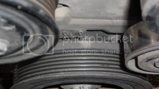

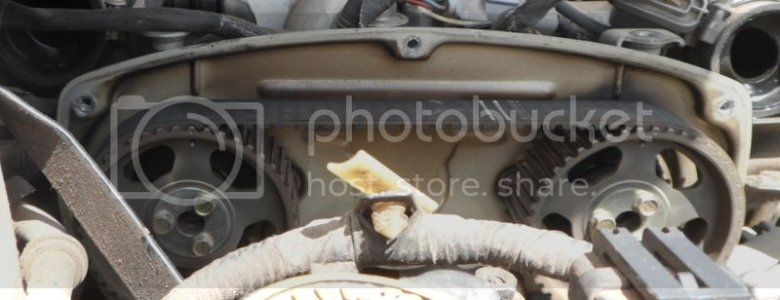

From every thing I know I decide to check the Timing belt. And to my Poor eye site It looks Off to me.
26e00281 a283 461d 8d4c 59c1fb172442
SAM 1181
I did rotate the engine by hand 4 times befor rechecking cam marks and Yellow timing marks.
why I'm unsure. i haven't pulled down the front of the engine yet. My Oldest son's Birthday is tomorrow and getting things going for him is going to slow things down. I will post shots of the rest of the tear down later but for now this is where I'm at. on a side note my Shop manual shows a Hydraulic Timing belt Tensioner I don't remember this on my old (93 SHO), and my wife's 3.0 had a offset bearing system.
SAM 1182
13,265
Well, I've never had to look at timing marks- due to a belt skipping a tooth or two- so I don't know how things line up after it's run for a while. But I do remember cars running like crap after jumping a timing belt tooth. Might be worth your while to replace the belt and check the belt tensioners and the harmonic balancer-- it is a 2 piece unit that can separate over time. try running a search on the timing belt jumping a tooth and see what's archived on the board. I know it's been discussed several times
7,521
looks like it is off one tooth. I don't think it skipped, I think the guy who put the belt on was not careful and got it off one tooth at installation. It will run remarkably different if the valve timing is off one tooth v. correct...
