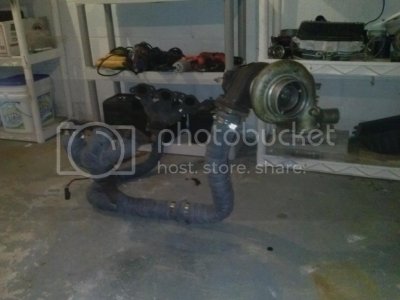

Drilled out broken bolts on the manifolds header wrapped the y pipe and manifolds. But i forgot to weld on the wastegate ****** ohwell i wrapped the y pipe in sections so only have to undo like 2feet worth. Waiting on the oil pan bung being welded then i can put the pan on and the ypipe and manifolds then build the down pipe and hook it up to the stock exhaust.

This setup is similar to yours, running pipe behind subframe then up in front of trans.

Pulled my abs off.didnt want it or the extra weight. Yea i sort of copyed your ypipe ha.

I was working on making my y-pipe tonight based on your guys pictures, and I ran into an issue, how are you guys tightening the bolts holding the y-pipe to the front exhaust manifold? I played with it a bit and the pipe is always blocking access to the bolts. It looks like the only way is to stick a wrench above the sub frame from the front of the car.

Probably going to have to use and end wrench.
