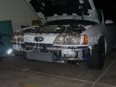

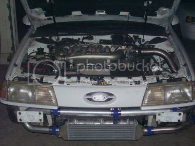

I am going to have the hot pipes Jet Hot coated but may also wrap them around the pan. Should look nice at least;).
Finished the IC tonight...
Turbo3007
Turbo3009
Yes I know my tires are backwards. I threw them on in a hurry:nut:
Some more duct tape for yall:cool:.

SHO's look so bad ass with a front mount. keep up the good work. It looks like you should be running soon.
BlackonBlack89
Mar 8, 2006
1,508
364
burlington county,NJ
That looks sick. The intercooler looks right at home sitting there. Get that thing running:thumb:
What size piping did you go with??? Is it 2" or 2.5"???

Looking good nik! One word of caution, with all those connections, take car to keep those pipes secured well, as the bouncing around and vibration could lead to a blow off at a connection. Are the pipes beaded at the ends?

If you approach wrapping with the idea that you need to replace it every year (or sooner depending on driving conditions), then corrosion becomes much less an issue. Also ,the wrap will trap small particles which become like little sandblasters over time. Not driving in the rain or on dirty roads will help a lot as well. Coated pipes will certainly withstand the abuse for longer, you should install new wrap on the same schedule as a non-coated pipe. On my car, only the up and downpipe are wrapped. Due to the location of the y-pipe, that wrap would get contaminated quickly, and you would likely need to change it often.
but he has that badass duct tape holding it up...thats good for 200 mph.

Well, took it for a spin to allow any "issues" to arise(and they did.) I put the turbo's regular waste gate back on with an adjustable rod(adjusts from practically zero boost to way more than enough). I have not cranked it and smashed on it yet since I have no idea what the AFR is but I can tell from driving it that I wont likely have turbo/pipe sizing issues. If I had to guess, I'd say the WG is set around 3 psi right now -a load of TQ comes at around 3000RPM and shortly thereafter, I hear the the WG opening(@ 50-75% throttle). It feels awesome and it is very tempting to see what it's got but not without watching the vitals. Also another thing I noticed was that is does not want to cruise at all. Any sustained part throttle causes RPM fluctuation and it wants do stall on decel sometimes.
Now that the "work" is done, I have to save for the pricey but required equipment. I cant wait to get this thing dialed in!!!
