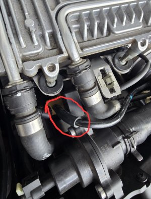

So yeah, it was the boost control solenoid (BCS), and it wasn't the boost control solenoid.
The boost reference lines from the turbos, to the controller, and from the controller to the wastegates are hard plastic. The connectors from those lines to the boost controller are rubber. The connector from the boost side into the controller had split on the back side. So when I went to remove it, it just fell off and started to crumble. So the BCS wasn't getting proper reference, and was limiting boost down.....which is a good thing.
So for 50 cents of vacuum tube, everything is kosher now. The car is ripping again. So back to data logging and messing with tunes.

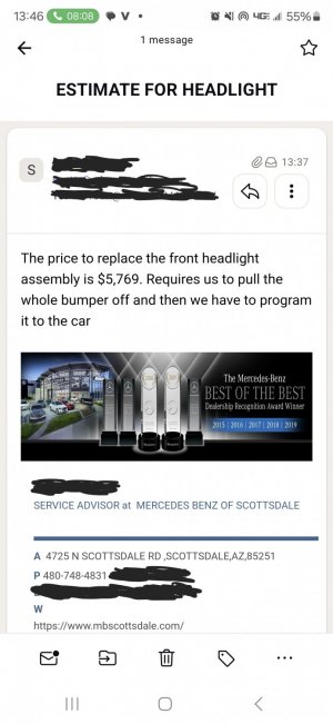

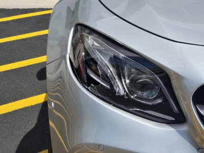

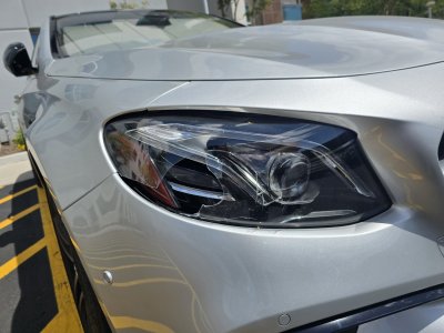

I was planning on going out and collecting data so I could start getting the baseline tune revision from AMR. But this happened. A truck decided to back into my E63. Fortunately it only broke the headlight.
20250418 134817
20250418 134826
Unfortunately it broke this headlight.....
20250421 102406

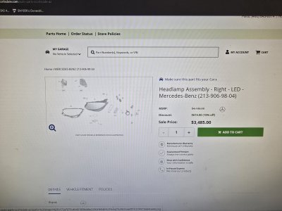

And here is the estimate......
Screenshot 20250421 102229 Gallery
Ouch....
7,417
9,717
Ouch with a sob or two added. That's crazy expensive.
Yeah, the windshield replacement was $2777, and now this $5800......I am glad I am not paying out of pocket.

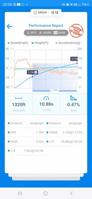

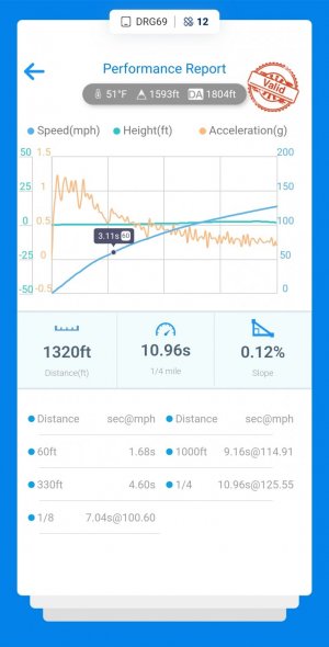

So I have been working with the tuner for AMR. The AMR 91 octane tune is not as fast as the Dyno Comp 91 octane tune.
The best the Dyno Comp 91 octane tune was below.
Screenshot 20250130 205857 dragy
The best the AMR 91 Octane tune is below.
Screenshot 20250504 215912 dragy
The AMR tune is calmer out of the hole which nets a faster sixty foot and 0 to 60 mph. They both run almost identical 1/8 mile times, and then the Dyno Comp tune runs a bigger MPH out the back end.
So I will call this a draw. With less than a tenth difference I am splitting hairs. AMR isn't as aggressive in their tuning in the beginning of the run. This helps the car go faster because traction is better, it probably save some wear and tear on rotational parts, and makes the launch a lot more manageable.
However, the AMR tune drives better, keeps the back of my car cleaner, and makes my garage stink less. Also the AMR tune allows me to datalog, and they are about to release switchable tuning. That means I can switch tunes without having to plug a laptop into my car ect...... Also all of the logs are clean in regards to fuel trims and pressures, Lambda is clean and stable across both banks, and there is zero knock.
So for now....AMR for the win.
