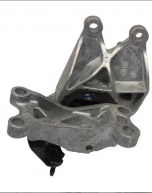

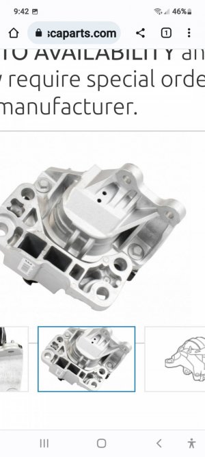

Screenshot 20220927 214139 ChromeScreenshot 20220927 214211 Chrome
Top picture is bottom View Taurus unit and lower is the Explorer transmission mount.
The engine side mount the difference is in the bracket attaching to the passenger side frame rail. They aren't interchangeable from what I can see. The difference in that mount is the bracket attaching to the frame rail.
