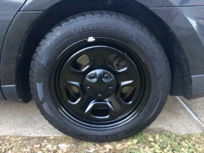

I went the OEM route for the noise maker delete as well and I'm happy with it so far.Found a suitable spare tire to replace the inflator kit.
And installed the noisemaker delete.
I see from another post you got the spare from an Explorer.I went the OEM route for the noise maker delete as well and I'm happy with it so far.
Did you go with an Explorer spare or one from a non-PP? I have a 16 PP and want to put a spare in it at some point.
